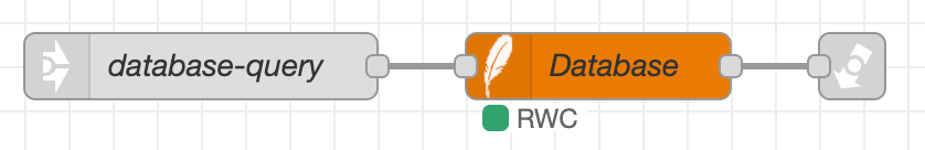

Since Node-RED 5
The Function node is able to make in-line calls to other flows and receive a response before continuing.
This can be useful where want to have resuable utility flows without having to deal with the state management of doing it in a pure flow-based approach.
For example, you want to be able to interact with a database from your Function node without having to resort to writing all of the code yourself; this is what Node-RED excels at. You can create a flow using one of the many database nodes available that the Function node can call directly.
Utility flows are created using the Link nodes.
The link out node is configured with the option return to calling link node option.
Using node.linkcall
A Function node can call a link node using the node.linkcall function:
// Set a query for the sqlite node to use
msg.topic = 'select * from orders';
// Call the `database-query` link node and await a response
const result = await node.linkcall('database-query', msg);
// result.payload contains the result of the database query
