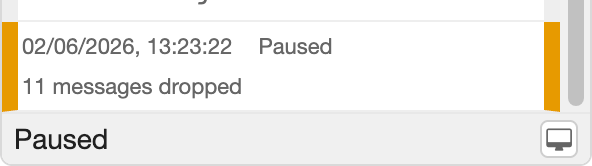

Debug paused
The button can be used to pause the debug output. Whilst paused, any new message will be dropped by the sidebar and the panel will report how many messages have been dropped.
