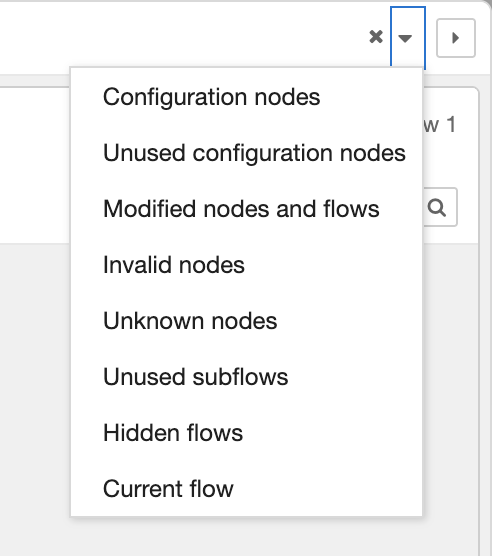

A number of predefined searches are available under the search menu dropdown.

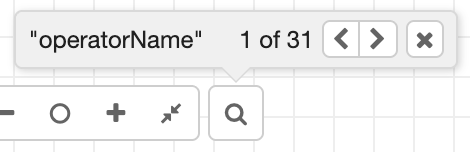

Search toolbar
When a search has multiple results and you select one, the search toolbar will appear to allow you to navigate between the search results without having to reopen the main search window.
